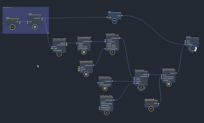

So I have a character animated and I have a butterfly which is animated as well. Question is how can I have the characters body emmit the animated butterfly as particles?

Yeah, you can def do that. It will be a lot easier to do with Bifrost Graph and keep it procedural.

thanks for responding could you please give me some tips on how to go about it, or point me to good bifrost graph tutorial relating to this please

Here you go a quick example.
I added noise in the character just to show that it can be deformable, Here is where you will add your character. I randomize the point rotation of the mesh so the "source_particle_rotations" get some initial rotation then a turbulence force to move the pts around, vary the rate so isn't constant and then I instance the wasp which in your case will be the butterflies.
This is a basic setup and you could do a lot more with it
 This is the network
