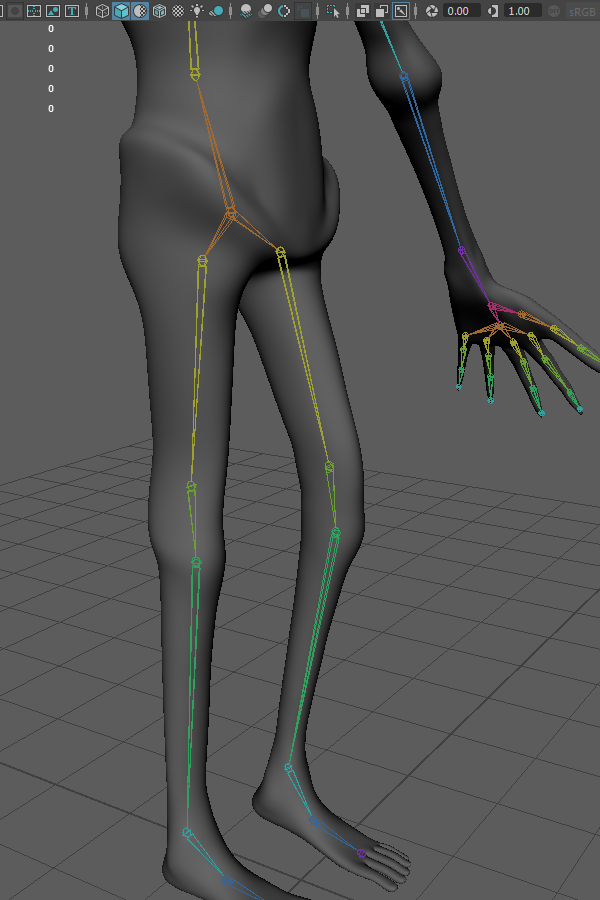

I have finished creating a rig and skin for my character, and when I added an IK control for the leg, it just messes up the model and the skeleton when trying to move the leg. Here's the IK in it's normal position:
y6sqjal6RBqFbBsOwSSIjQ
and here's the IK when moving it:
Uk2oQ8VgSE_sjHnzjBQ0sg
I have no idea why it's happening or how to fix it, I also attached the maya file and the model file so you can check it for yourself (There is no IK in that file, I deleted it)

mspeer
Hi!
You should not ad IK controls to full or almost straight and unrotated joints.

mspeer
Hi!
Just for a test slightly rotate some of the joints (in the wanted direction) and add the IK handle again to see the difference.

mspeer
Hi!
After changing the rotations and before applying the IK Handle you need to "Set Preferred Angle" (set starting pose) for the skeleton, then it works:

mspeer
Hi!
Just watch the animated GIF, it clearly shows the difference between left and right leg.

mspeer
Hi!
If you still can't see the difference between the right leg (straight) and left leg (curved), then i can't help you further.
Just rotate the individual joints manual.
