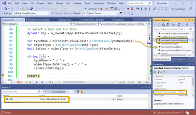

adam.nagy
in reply to: rjay75
If you treat the selected object as dynamic then you can still access the Type property. With Microsoft.VisualBasic assembly you can also get the TypeName
Adam Nagy

Hi Adam,
Thanks for your suggestion! In general, am not that fond of using the dynamic keyword, but I will definitely review your solution for replacement of my current solution. As mine has downsides as well.
As with the solution of Rodney, I am currently using reflection to get the ObjectTypeEnum:
        public static ObjectTypeEnum GetObjectTypeEnum(object comObject)
            const string propertyName = "Type";
            if (comObject is null)
                throw new ArgumentNullException(nameof(comObject), "Argument cannot be null.");
            try
                return (ObjectTypeEnum)comObject.GetType().InvokeMember(propertyName,
                    BindingFlags.GetProperty | BindingFlags.Public | BindingFlags.Instance,
                    null, comObject, null);
            catch
                throw new MissingMemberException($"Property '{propertyName}' is not found on object.");
