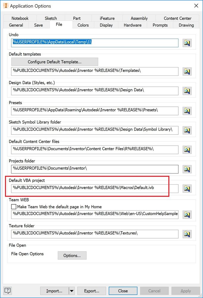

we are using Inventor Professional 2015, SP2 update 6 with network licenses in our company. Since a few weeks we have problems with the VBA plugin. If someone logs on to a new computer using his Windows network user account, the VBA Plugin doesn’t work. You can open the VBA plugin but it’s “dead” (see the picture below) – you can’t even open a project manually.
The strange thing is: if you log on to a computer you have been logged on to before, everything still works.
I work as a design engineer and have no idea what to do. We have asked out IT department for help but they also couldn’t solve the problem.
Thanks for your help.

Hey @Anonymous,
Please do following check:
On the new computer, check inventor's Application options: Find Default VBA project settings in File tab.
Is it pointing to a Default.ivb file?
If yes, try to check whether Default.ivb file can be accessed manaully with the login user.
If not, please specify Default VBA project to a certain path which the login user can access it.
Jane Fan

Hello
the /INSTALL argument worked - thank you so much 🙂
