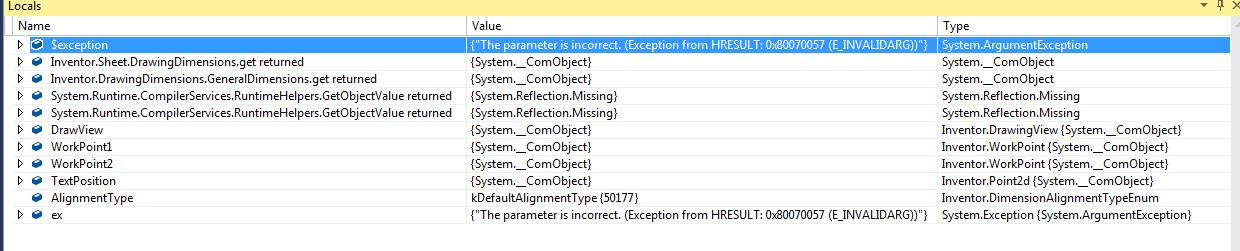

I'm trying to create dimensions for an assembly in an Inventor drawing using VB.net. I found a function that uses workpoints to create the dimension. However, when I run the function, it finds the workpoints, makes them visible, but gives an exception
{"The parameter is incorrect. (Exception from HRESULT: 0x80070057 (E_INVALIDARG))"} when it gets to the point where it is supposed to create the dimension. I am running Inventor 2016 update 2. Here is the sub I'm using to create the dimension:

Here is the list showing the exception I get:
I've also attached the code that calls out the sub. Can anyone give me a hand with this?

Since your code contains some your own functions that do not work at my side, I followed your workflow to create the isolated code as below. It works well, the files I tested with are also attached. Hope it helps you to diagnose the problem at your side.
