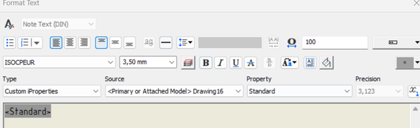

I'm wondering if it's possible to pull text/data from other documents and into Drawing Templates.
Example:
I have a drawing for a pipe and i want to pull data from a WPS (Welding procedure Specification). Lets say this document gets created by a different person but always in the same path as the output drawing. is it possible to create a dedicated field in the WPS, which again can be pulled into the dwg?
I would like it to show as source in "Format text" dialog.
i have no clue on where to begin on this and i would appreciate any inputs 🙂

Update.
I'm able to extract information to a custom Iproperty and then use it on the sheet. the text does not display for some reason. and im not sure how i will make the path change for different documents.
GoExcel.Open("C:\Users\Patrick\OneDrive - Rørtek As\Desktop\TEST-WPS.xlsx", "Ark1")
iProperties.Value("User Defined Properties", "Standard") = GoExcel.CellValue("A3")
iLogicVb.UpdateWhenDone = True
The iproperties does get information from excel sheet here.
but this plot does not work.

this works now. but i need to be able to change Reference excel document.
