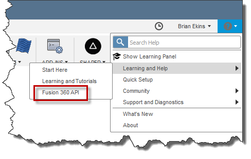

The best existing resource is the Inventor API help, which you can access from the help menu, as shown below.
I'm planning on releasing a series of training videos that go into detail on all aspects of the API.  I don't currently have an ETA on when they'll start becoming available but it is something I'm working on in between other projects.

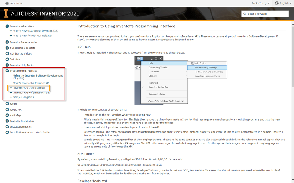

I think You can start from this page:
http://help.autodesk.com/view/INVNTOR/2020/ENU/?guid=GUID-6FD7AA08-1E43-43FC-971B-5F20E56C8846
This is the online API programming help, you can also find how to launch the local API help from the page, and also some blog links from it.
Below circled in red is the content for Inventor API Programming, I think you can firstly read the User's Manual to get the basic concepts for Inventor APIs and try the sample codes in them:
Hope this helps.
