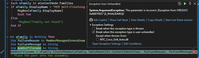

It seems that I need to specify the row. I don't know how to determine the row from the information that I have.
Here's my error.

Here is the error
Message 4 of 10

Sorry, I should have specified that CreateMember is looking for a ContentIdentifier or the TableRow object, not just the index. Instead of 14, try oFamily.TableRows(14) or oFamily.TableRows(14).ContentIdentifier
Message 6 of 10
J_Dumont
Thanks for input.
This is what happens.
oFamily.TableRows(14) fails here.
oFamily.TableRows(14).ContentIdentifier fails here

jjstr8
Sorry, I was mistaken about using .ContentIdentifier and your earlier row number. It should take a TableRow(14), 14, or TableRow(14).InternalName. Regardless, where you add an occurrence, it needs to be to the ComponentDefinition, not the Document object.
Message 9 of 10
J_Dumont
It was an issue with the component definition.
Below is the code that is working.
Thank you both so much for replying and helping me with this issue.
