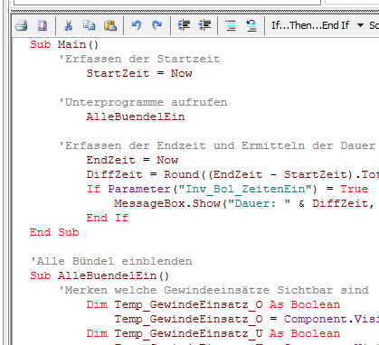

Hello, is it possible to display line numbers in iLogic window?

Nope.. Line numbers in the ilogic editor dialog box are not possible.

It is possible to see on which line you are in the lower right of the Ilogic Editor as shown in below screenshot.
However it is not possible yet to show the numbers in front of the line (Which is quite a shame....). Needless to say, I voted for your idea.

I'm not sure if you've discovered this already, but the Autodesk Inventor 2022.2 Update added line numbers to the iLogic rule editor. My thanks to Randall Mabery of IMAGINiT Technologies for pointing this out.
