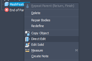

@redondelosCRREA - I'm not seeing any attachments. You should be able to right-click on the mesh feature and Convert to Base Feature
After that, you can do a Direct Edit to scale, move, or rotate.
