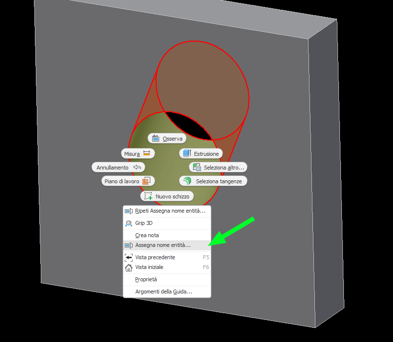

I'm trying to do something that seems simple, but it's giving me a tough time. I want an ilogic program to bisect two lines of a swept hole to create a centerline in the section view of a drawing. Automated centerlines won't work in this case for some reason, probably because its a sweep rather than a hole. I don't want to have to select the edges with mouse clicks. The edges will be the same on every drawing made from this part. It will be part of a rule that creates the drawing view. I have tried using named entities in the model to create edges and then geometry intent but no luck so far. Attached is a video of what I'm trying to do. Seems so simple on the video but it's not working yet. I tried asking chatgpt and was running in circles with it. Any ideas?

Hi!
Try seeing if this method could work for you.
Basically, in the 3D model, assign a name to the face you created, using Assign Name to Entity (e.g. "Faccia0")
And then, in the drawing, once you've identified the view you're interested in, you can do something like this:

grantDHM4Z
Sorry for the late response but thanks to both of you for your answers. I was able to get it with some finagling. Here's the final code I used for anyone interested.
