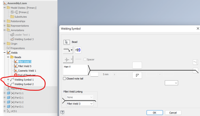

However, I want to edit note tail of weld symbol or make new weld symbol in 3D Assembly Enviroment by API
It is possible?

NhatHaBG
Oh this is new function, great
However, I can't find the welding symbol that is created in welds using the above method.
Can you show me how to access it; Thanks

Message 9 of 12
WCrihfield
Hi @NhatHaBG.  I believe that accessing the WeldSymbol object on the model side may only be possible if you have created a 3D annotation for it.  You can create 3D annotations that are welding symbols from the Annotate tab of a model document.  The welding symbols you create that way can be accessed like the below example.  And the TailNote property is Read/Write here too.
Sub Main
	'if it is not a Weldment type Assembly, then let user know and exit rule
	If ThisDoc.Document.SubType <> "{28EC8354-9024-440F-A8A2-0E0E55D635B0}" Then
		MsgBox("A Weldment type Assembly must be active for this rule to work. Exiting rule.", vbCritical, "iLogic")
		Exit Sub
	End If
	Dim oADoc As AssemblyDocument = ThisDoc.Document
	Dim oWeldmentDef As WeldmentComponentDefinition = oADoc.ComponentDefinition
	Dim oMWSs As ModelWeldingSymbols = oWeldmentDef.ModelAnnotations.ModelWeldingSymbols
	If oMWSs.Count > 0 Then
		For Each oMWS As ModelWeldingSymbol In oMWSs
			Logger.Info("Name = " & oMWS.Name)
			Dim oMWSDefs As ModelWeldingSymbolDefinitions = oMWS.Definitions
			For Each oMWSDef As ModelWeldingSymbolDefinition In oMWSDefs
				Logger.Info("TailNote = " & oMWSDef.TailNote)
				Dim oWS1 As WeldSymbol = oMWSDef.WeldSymbolOne
				Try : Logger.Info("WeldSymbol Above Ref Line Thickness = " & oWS1.Thickness) : Catch : End Try
				Dim oWS2 As WeldSymbol = oMWSDef.WeldSymbolTwo
				Try : Logger.Info("WeldSymbol Below Ref Line Thickness = " & oWS2.Thickness) : Catch : End Try
			Next
		Next 'oMWS
	Else
		Logger.Info("There were no ModelWeldingSymbols.")
	End If
End Sub
Those will be the ones you see inside the Annotations browser folder in your model browser tree.  But I do not believe we have direct access to the true weld symbols that are located below the 'Welds' folder in the model browser tree through the API yet.  We can access the information that is included within those 'real' symbols indirectly, but it is ReadOnly, and formatted with XML tags though.  The only WeldBead objects that will include any data within the WeldInfo property are the ones you have created 'real' weld symbols for.

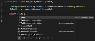

G.Binl
@bradeneuropeArthur
How are you doing, this code works well and give some insight of how this command works.
you can select all the welds and change them all at once. I have tried to modify this so that i can do a find and replace per sheet and for the life of me can not figure out how to do this.  we have many sheets and many welds that will be updated per job that is currently done manually. I would like to replace 1A with A for the whole sheet. leaving 008
example:
W-1A008 would be W-A008
W-1A009 Would be W-A009
I use this for user interface
Any help would be great.
