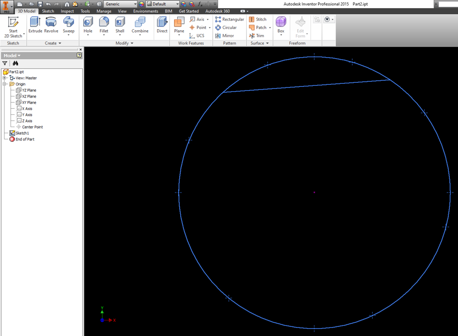

Hello everyone,
  • I have created a sketch with constriction lines and placed some points, on the sketch as a guide path.
  • I want to extract the coordinates of all points and export to excel. (Using VBA iLogic)
  • Points are created using sketch points.
  • I just want to extract the coordinates for sketch points that created manually. (not for line endpoints and arc endpoints)
  • I have attached the sketch image for reference, thanks in advance.Picture1.png

Thanks for your response, I used the iLogic code its works. but it is also considering the other points such us
  • circle center point,
  • projected origin point,
  • and also endpoints of a line.
is there a way to extract only the sketch points that are created manually. (ie. excluding the above-mentioned points).
as you mentioned it is in "cm" in excel. is there a way to get it in "mm".
thanks, again for the support.
I have attached the image for further reference.

There are different approaches possible, below 2 possibilities, the one uncommented is best i think
conversion is commented
For Each oSketchPoint In oSketch.SketchPoints
'If oSketchPoint.HoleCenter = True Then
If oSketchPoint.AttachedEntities.Count = 0 Then
'Values in cm by default , multiply by 10 to get mm (other approaches possibly with UOM conversion)
osheet.Cells(x, 1).Value = oSketchPoint.Geometry.x * 10
osheet.Cells(x, 2).Value = oSketchPoint.Geometry.Y * 10
x = x + 1
End If
Next oSketchPoint
