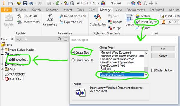

I would like to add / attach a text file to automatically created part files to hold some metadata.
Is it possible to create / embed and write to a wordpad file with the API? The screen shot below shows the "manual" workflow to get what I am ideally after (less writing to the file).
I am having difficulty finding anything in the admapi reference. Can anybody provide some examples of how to create an embedded wordpad file and write to that file?
Other ideas on embedding /attaching metadata in a text file format to a part model would be welcome as well.

One thought would be to use a Microsoft.Windows.Forms.RichTextBox object, and its various methods, to create the file, then the usual Document.ReferencedOLEFileDescriptors.Add method.

 If you can live with basic text, creating and embedding a text file is pretty simple.  Here's a quick VBA example.
Public Sub EmbedTest()
Dim fileSys As FileSystemObject
Dim embedFile As TextStream
Set fileSys = New FileSystemObject
Set embedFile = fileSys.CreateTextFile("C:\temp\myTestFile.txt")
embedFile.WriteLine ("First line of text")
embedFile.WriteLine ("Second line of text")
embedFile.Close
ThisApplication.ActiveDocument.ReferencedOLEFileDescriptors.Add "C:\temp\myTestFile.txt", kOLEDocumentEmbeddingObject
End Sub
I'm not sure what code environment you're doing this in, but an add-in might let you do something like @WCrihfield  described, where you create the RTF object then stream to a file for embedding in the Inventor document.

you can create and save RTF files like this in an iLogic rule.
imports System.Windows.Forms
Dim doc As PartDocument = ThisApplication.ActiveDocument
Dim tempFileName = IO.Path.GetTempFileName()
tempFileName = IO.Path.ChangeExtension(tempFileName, "rtf")
Using RTB As New RichTextBox
    RTB.Rtf = "{\rtf1\ansi{\fonttbl\f0\fswiss Helvetica;}\f0\pard This is {\b bold} text.\par} "
    RTB.SaveFile(tempFileName, RichTextBoxStreamType.RichText)
End Using
Dim refDoc = doc.ReferencedOLEFileDescriptors.Add(tempFileName, OLEDocumentTypeEnum.kOLEDocumentEmbeddingObject)
refDoc.DisplayName = "Foo Bar"
IO.File.Delete(tempFileName

Not sure what your meta-data is exactly and how much info you are storing, but you could also look at using attribute sets instead of embedding an object. That way its all structured / easy to query and you dont have to deal with an embedded file.
CAD_CAM_MAN
in reply to: CAD_CAM_MAN
Thank you to everybody that responded. All work. I believe the attribute set option suggested by matt_jlt will suit this project best. I did not realize such an object existed. 🤔 This opens some doors!
