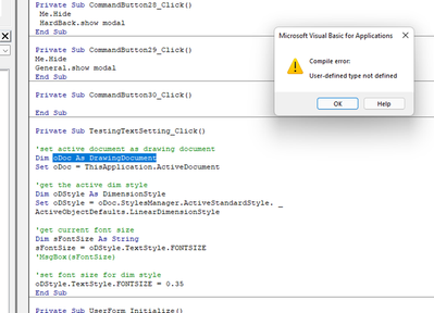

There is still a problem. The problem is with this Line: Dim oDoc As DrawingDocument
That is DrawingDocument is not defined
Message 10 of 21
greneebb
This is the result.

I am not as knowledgeable as some others, but my guess would be that you are not pasting this in the correct location.  Are you pasting the code into a Module?  If not, please insert a new Module and paste it in there(in the browser, Right Mouse Click on the Project, then left mouse click on the Insert, then left mouse click on Module).  Then paste the code in that new module and try to run it from that Module.
Message 12 of 21
greneebb
Thanks for your response.
However, I think it is pasted correctly. But notice that the message says that DrawingDocument is undefined.  So, how is this to be defined?
Message 13 of 21
greneebb
Where can I find styles and standard editor?
Message 14 of 21
shastu
The Line: "Dim oDoc As DrawingDocument" is how you define it.  That is what is confusing me.  That line should not throw an error as you are just telling it to set oDoc as a drawing document.  In other words, if you try to run this code from an ipt file or an iam file, it will error out because it is not a drawing, i.e. dwg or idw file.  Is there any way that you can send me the file that you pasted this code into?  If you are pasting it in a file, send me the file.  If you are pasting it in the default.ivb, then send me that file.

I don't have inventor
Message 17 of 21
greneebb
Do I have to have Inventor?
Message 18 of 21
shastu
Yes.  Given that this is an Inventor forum, I just assumed you were working with Inventor.  What are you working in?
Message 19 of 21
greneebb
I am using AutoCAD
