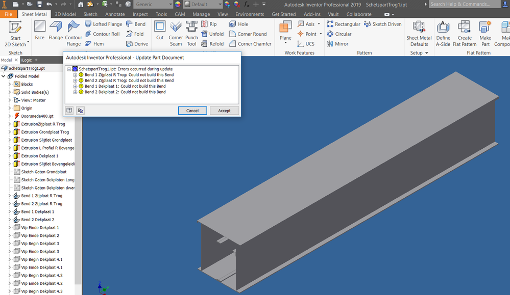

I've made 2 rules to change the sheet metal rule for 2 different solid bodies.
When i change the thickness for one of the bodies, the rules work fine, but when i change the
thickness for both solid bodies at once, then i get an error on my rules.
I can't figure out why, since this works fine when i only change the thickness for one of the bodies...
i've attached a screencast and a file with the rules i use, and with the error i get.
Can u help me out on this?
If you have other questions or need more info, let me know.
thx in advance!
Message 9 of 63
in reply to: Anonymous
@chandra.shekar.g
These are both files.
When i've changed a thickness, and i use the update command, then i get an error also,
but when i use the save command, then i don't get this error. do i have to add something additional to my rules to avoid this?
Thx in advance!

Message 11 of 63
in reply to: chandra.shekar.g
@chandra.shekar.g
I added the update command to my code, but i've still got the same errors...
When i change one of these parameters marked in red in Doorsnede400.ipt at the time, and then save SchetspartTrog1 instead of using the local update command, i have no errors.
But when i change both of these parameters marked in red in Doorsnede400.ipt at the same time, and then save
SchetspartTrog1 (again, not using the local update command), then i have an error.
Why does it works fine when i only change one of these parameters, but not when i change more then one parameter at the same time?
And why does i get an error when i use the local update command (When only changing one parameter), and no error when saving SchetspartTrog1 instead? This is less important, since it works fine when i use the save command instead.
If you need more information or details, let me know!
Thx in advance!
Message 12 of 63
chandra.shekar.g
@Anonymous,
On updating through UI, there is error in SchetspartTrog1.ipt file as shown below. If this error is resolved, then update command will work in iLogic rule.
Thanks and regards,

Message 16 of 63
chandra.shekar.g
@Anonymous,
In both files, only 3 sheet metal rules are defined namely "PLAAT KGW 002 S235JR" , "PLAAT 003 LASERFORM S235JR" and "PLAAT 004 LASERFORM S235JR" as shown in below image. Other sheet metal rules ("PLAAT 005 LASERFORM S235JR", "PLAAT 006 LASERFORM S235JR" and "PLAAT 008 LASERFORM S235JR" )are not defined.
Can you please resolve geometrical error which is appearing on update command as shown below?Update_Error.PNG
Thanks and regards,
CHANDRA SHEKAR G
Developer Advocate
Autodesk Developer Network
Message 17 of 63
@chandra.shekar.g
I added the sheet metal rules to the documents, so please find in the attachement the new files.
I also made a new video.
https://knowledge.autodesk.com/community/screencast/e2c3a548-47a4-44b5-9dfe-5f705b9ecac4
The geometrical error appear because the sheet metal rules for the ''zijplaat" and the ''dekplaat" aren't updated correctly with my rules i've made. This only appears when we change the thickness for both solid bodies.
When we only change the tickness for one solid bodie at the time, the sheet metal rule for the specific solid bodie updates correct.
If you need anything else, or more info about something, let me know.
Thx in advance!
Message 18 of 63
