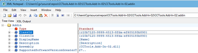

Do you mean this file:
Unfortunately I am not allowed to drag the file here....
This is what it is in this file.
Message 9 of 9
JelteDeJong
I'm not familiar with this way of viewing XML files. (I like to open them with notepad) Anyway, I see potential problems.
  • The dll name is surrounded by square brackets. They should not be there.
  • If I'm correct your <SupportedSoftwareVersionGreaterThan> is for Inventor 2023. I don't know which version you are working with but I would set it to 16 (Inventor 2015) for debugging purposes. Just to be sure that is not the problem.
