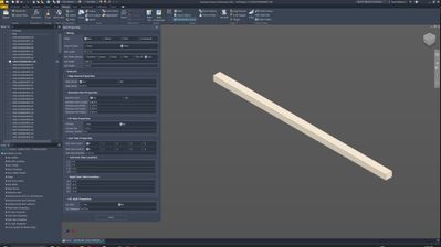

I'm making a part that has hundreds of model states. I edit it via spreadsheet to make tens and hundreds of model states at once, save the spreadsheet and close it out, let the inventor part load the new model states, but then it shows I need to manually activate and local update every single model state. That's going to take forever.
I've presented this issue before and was given these codes. They are no longer working (not sure if it's cause of a basic update or if it's cause I'm on 2026 instead of 2025

I've tried running those rules, rebuilding all, and updating  mass. All with scope as single member, scope as all members. I don't know if 'Global Update' would work, but it's greyed out so I can't even try it.
I need help finding either a command that will update all model states or if there's some sort of rule I can write and run to go through and update each model state.

When I run the code (from my original post) it cycles through the model states, but when I activate different model states after, it still shows that I need to do a 'Local Update' on each one manually
I ran the code you sent too and it shows the same. With scope as single member and all members
