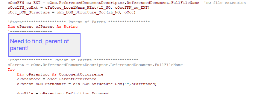

RoyWickrama_RWEI
I am developing a rule shown below to extract all the data required for the product documentation in huge assembly environment (couple of thousand drawings).
The rule has following functionalities:
  • reference documents (parts and assemblies) excluded
  • phantom parts excluded
  • phantom assemblies excluded
However, I still have a problem connected with some parts reside in one or multiple phantom parents. If the parent of a document (part) is of phantom BOM structure, the true parent of the document is the parent of parent and so on until the parent of normal BOM structure is hit.
From my side, if I know the parent of parent, I can get around this issue (at the bottom of this rule). But, it looks like a lot to do!
Could you help, please. Thanks.

RoyWickrama_RWEI
Hi Chadra Shekar;
I have a rule that scan through all the occurrences. I need to filter library parts.
I tried with the following:
Dim openDoc As Document
openDoc = ThisDoc.Document
Dim oDoc As Document
If oOcc.IsModifiable = True Then
End If
It does not work for occurrences.
I request you to help. Thanks.

RoyWickrama_RWEI
Hi Chandra Shekar;
In the interest of determining the parent of a standard part:
  1. if the parent is phantom, the true parent is the parent of the phantom parent. It is fine if the parent of parent is not phantom. I am OK up to this level.
  2. unfortunately, if the parent of parent is phantom, to find the parent of the standard part under consideration, I need to find the parent of parent of parent! This is where I need help. Rule and fake-sample assembly are attached here to. Could you help me to get this around.
In the sample, p0026 has sa0017, sa0012. Now, it is hard to decide the parent of each occurrences. To get this around (generally speaking, in case the parent's BOM structure is phantom), I would like to find:
  • parent of parent
I keep trying. Not sure will succeed. Please help.
Thanks.
