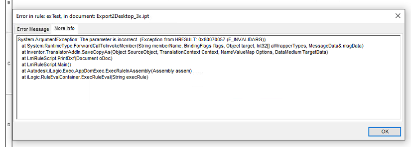

Hello
With some help (from this forum) the code to export a list of .idw files to dwg, dxf, pdf is working - but only on my machine!
(actually pdf will work on a colleagues machine - maybe it's the .ini file - will test tomorrow).
Below is a section of the code - if you edit the file path ( 4th line down) to a .idw can you export a dxf ( will need to create an .ini file & save here - %USERPROFILE%\Desktop\Batch Export\ACad2013.ini - by manually exporting to dxf first & saving the configuration)

Error being seen on a different machine is:

WCrihfield
Judging by your description, the file path specified for the .ini file, and the second error image, I would definitely suspect that the .ini file is not being found on the other machine.  I am not currently using Vault, so I don't know if that first drawing file path would be causing any problems on the other machine or not, but it also looks like a local path.

JelteDeJong
I'm not sure why it didn't work. but I found some things that could go wrong. I changed a couple of things in your rule to improve it a bit. have a look if this works better for you.

andrew_canfield
It's working but I don't know why!
The other users machine was new (ish) - the code failed at first.
One of the test drawings was opened & manually exported as a dwg to test.
The code was reran & it worked - happy days.
Thanks for the help.

WCrihfield
Just a quick tag on note about that process, and why you might have to export one manually first to get it to work.  When you don't specify an .ini file for it to use, or it can't find that file (within something like a Try...Catch), it will basically try to export the DXF the same way it was done the last time.  Problem is, if you often change any of those settings, you don't know how things may have been set-up the last time you exported a DXF.  So doing a manual export, and setting things up the way you want, just ahead of a batch of DXF exports, will normally work.
