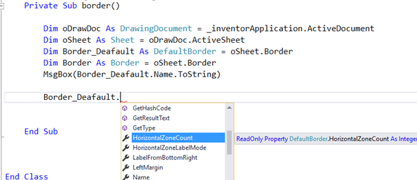

HermJan.Otterman
Hello David,
I don't use VBA for programming, only VS and ilogic.
But I do use VBA to watch the object structure.
these pictures are from VBA
from VS:

OK, it turns out that it's a bit nuanced.
You can get a DefaultBorder object from a DrawingDocument (in VBA!), but only if at least one Sheet object therein already has a DefaultBorder object. If it does not have one, it will not accept a new DefaultBorder object using AddDefaultBorder()! (AddBorder(), when fed a DefaultBorder object, appears to work.)
That is, even one of the standard "Insert default border' VBA code examples provided by Autodesk ("InsertDefaultBorder") will fail where it is run using a sheet which does not already have a zone-type border.
At least in VBA. It works in VB NET.

As well, given that all of the BorderDefinition objects are for ordinary, not zoned borders, I was correct in saying that one cannot derive a DefaultBorder object from any BorderDefinition object, not even from the [hardcoded] "Default Border" found in that collection.
However, if you want a DefaultBorder object with the default parameters, you can get one by working on a sheet that does not have a border, and calling the AddDefaultBorder method on it, but without using any arguments. (All arguments thereto are optional.) Thus, for example, you can create a new sheet (newly created sheets have no borders), put a default border on it, then work with that object to query, obtain, and/or modify any of its parameters.
I hope this clears the matter up once and for all.
