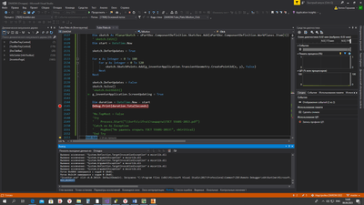

when exiting sketch editing (sketch.ExitEdit()), after drawing a large number of points (if oHolPoint.HoleCenter = True more than 9000, if oHolPoint.HoleCenter = False more than 6000) the System error pops up.ComponentModel.Win32Exception
HResult=0x80004005
Message = Not enough quotas to process the command

anton.gorschnev
anton.gorschnev
anton.gorschnev
it helps to draw points without entering edit mode, but performance decreases significantly. maybe the problem is in the old version of the Inventor 2014.
