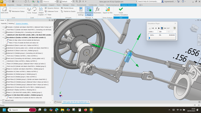

The die block (highlighted) runs in a curved slot (not shown) and is constrained in the slot by mate on it's outside, plane, face and by tangent on it's convex face. When in DS, the tangent restraint is not included as a standard joint and so the mechanism comes apart when the sim is run. NB I am self learning this and do not have a book! But I am only playing as an amateur.

A little more digging suggests that I need to manually insert a 3D contact joint. I'll try that.
mgreenland5KXBS
That 'might' be working but it slows the motion down so much that I can't wait long enough to find out!
