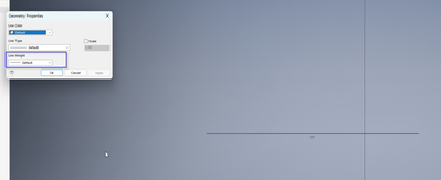

This may be a simple question...
I am trying to set the sketchline line weight to the "Default" setting in vb.net. But the line weight property is a double. Is there a way to set it to the default a different way?
If I use the LineWeightTypeEnum there are only two values and neither is default.
Just curious if anyone else has ran into this situation.

WCrihfield
Is this sketch in a model document, or in a drawing?  What you are showing looks like what we see in the 'Document Settings' of a model file, on the Sketch tab.

On second thought...If this were in a model file, I do not know how you would set a SketchLine's LineWeight to a 'default' setting, like what you see in the dialog.  I would assume its default would be zero (or whatever the minimum allowed would be).  There do not appear to be anything like Layers or SketchStyles / LineStyles in the StylesManager in a model.
If it were in a drawing, then I would suggest that the default was set by whatever Layer the geometry was on.  My guess is that they just reuse the same dialog in both places, and the 'default' settings are simply the default values to show in those dialogs, unless something more specific has already been set, and the 'default' settings are primarily for use in drawings.  As far as I recall, the line weights in a model sketch, if set to specific values, will only be used if the Document Settings, Sketch tab settings, are set to DisplayLine Weights = True, and Display True Line Weights is also set to True.  Otherwise they would would just get bundled into the 3 group line weights (by range).  We can access those document settings for the Sketch tab by code, if needed.

Tiffany_Hayden_
@WCrihfield  Thanks for this reply. Yes this is in a model, within a sketch.

Hi @Tiffany_Hayden_
Try setting it to 0.001 ( which will be in cm). I think you will see that reset it to default.

@Curtis_Waguespack Okay! I was defaulting to .1 but that was way too large! lol How did you know that that was the default? Since the default doesn't have a value. Just curious!

Curtis_Waguespack
Ha! I knew you were going to ask me how I knew that!
The truth is I don't really know 🙄
I'm guessing there is probably some other place in the API where we do the same thing but it IS documented for that case...
but in this case, I noticed the datatype was a Double and it just sorta came to me that we'd need to use 0.001 for Default, based purely on some thing I did in the past that I have now forgotten.

So.... The setting to .001 sets the property back to default but visually the line doesn't change. So I go back into the properties for the line and it is set to default but when I just go into the line weight property and do the dropdown and click on default the lineweight changes in the sketch. It's like the sketchline doesn't know that the line has been changed but it clearly says "Default". Have any of you seen that behavior? I can take a video if that would help.

I think it's working but the little format display is a bit wonky in that it stays at the last line weight that was used, at least that seems like what I am seeing.
Try this:
Create 2 rules as shown with the added line of code to select the line, and then run each rule to toggle between them. I see the line update as expected when running the rules to set it back and forth.
