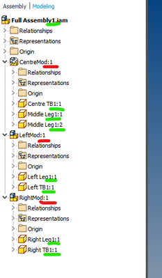

Thank you @Ralf_Krieg,
It is now replacing the parts in each subassembly but not the replacing the sub assemblies in the main assembly.
I have attached a very simplified assembly for reference.

Message 5 of 8
Okay thanks for trying @Ralf_Krieg. I'm not really sure what is going on. This is what I am getting.
But I will keep trying and let you know if I figure it out. Thanks Again.

I have copied your test assembly around 10 times with different results.
4 times all copied correct like my first test
4 times your mix with not replaced subassemblies
2 times a mix with replaced subassemblies but not all parts were replaced
I could not find a reproducable reason for this. I think this could founded in the occurrences collection. Replacing an occurrence while traversing the collection, could invalidate the collection. Maybe I'm right, maybe that's nonce.
