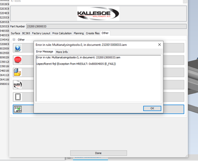

I am Looping through an assambly  bom Stuctured , with Ilogic to get date form the componemt/part Assambly  but if someone have use Phantom I get this error. Is there a way to get it to work  ?kinder of workaround ?

Can you explain a little bit more detailed. You traverse through the rows of the structured BOMView. What do you try to get from the BOMRow?
There is a property "Promoted" who's value is true if the BOMRow is promoted e.g. by a parent subassembly is a phantom, otherwise it's false.

I am trying to get information (properties form the BOM to excel ) and to see if the model have a drawing and a lot more. The project is very complete but I think most of it will just to noise. To add here. The code just error then it try to get data form files that are part of an phantom assembly

And what kind of infomation did you try to access? If you can't give detailed information, the only solution would be that you strip your code down to the failing part by yourself until you found it or enclose your failing part code in a try-catch statement to suppress the error messages.
As an example i traverse through the structured BOM view, get item number, quantity and two iProps for each row and write it to the iLogic logger. Even if there are promoted parts in the BOM view, no error is raised. Can you confirm that with your assembly or is it failing also?
