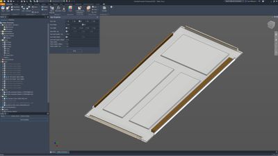

This is a long one.
I make doors. They can be different Widths and Heights, among different Types.

Issue is.
When I run the 1K rule it works great cuz there's only one 1K model
But for the 3F there's two 3F models that are different sizes.
I need the 3F 3-6 model to be active only if I have the DoorType ="3F" AND the DoorWidthOptions = "3-6"
Then to suppress it if DoorWidthOptions = "3-0", "2-10", "2-8", or "2-6"
This is what I wrote and it doesn't work.
If DoorType = "3F" And DoorWidthOptions = ("2-6" or "2-8" or "2-10" or "3-0") Then

Also, here's some pictures so you see what I see
Form in top left of display with all my options
If DoorType = "1K" Then
If DoorType = "2K" Then
If DoorType = "3F" And DoorWidth <= 40 Then
If DoorType = "3F" And DoorWidth >=40 Then
If DoorType = "3S" Then
If DoorType = "50" Then
