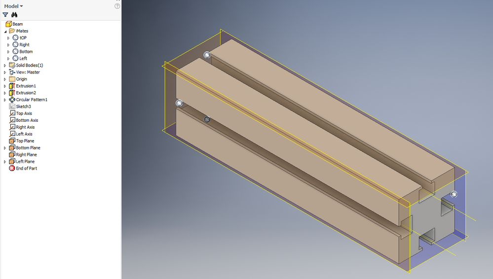

I will be constraining parts/assemblies to an extruded aluminum beam.
This beam has 4 slots and thus four composite iMates.
This is a simplified shaft clamp and it has 2 similar composite iMates that mate to any slot on the beam. There are 2 to allow me to flip the clamp over. (We have lots of different clamps so that is necessary). There are also other iMates on it that are important
Part 1
First, I ALT+drag-and-drop the composite iMates to the slot I want:
Next, I want the code to reapply the iMates within the composite iMate and then delete the composite iMate so it looks like this:

When you ALT+drag a composite iMate over another, before releasing the mouse, Inventor fires a new relationship event (in code) to visualize what will happen. Thus, if you ALT+drag a composite over another composite, drag it away, and then bring it back, it fires a new relationship event multiple times in the AssemblyEvents_OnNewRelationship. This is a problem because I was thinking of using that event to add iMates and then delete the Composite. Or can I still do that anyway?
In other words, I am wondering if anyone has advice or some pseudocode about the best way to implement this idea. I was thinking about handling the assembly Events to do it but not sure if this is best. If all else fails, I can have multiple commands that I manually fire but this is less than optimal. Also, do you think it would be possible to have the code change the Position representation of the clamps depending on which iMate I grab?

so in short? you have 4 places that you want to be able to place some component (A)?
all 4 places must have the same iMate composite and also the component (A).
the create a new empty component (E) that has only the imate composite.
in your assembly place on all four places the (dummy) empty component (E)
than with code you can use replace to change Component (A) for Component (E) 1, 2, 3 or 4..

I got the general concept working and I still need to do some modifying but here is the code so far. Fair warning, I got my degree in Mechanical Engineering, not Computer science. The code is very sloppy and there is no documentation.... yet. To get it to work you need to change the iComposite name to "Regular" or "Flipped." I still need the code to change the Position Rep depending on which iComposite you grab and I need to be able to make it work on mutiple Composites.
