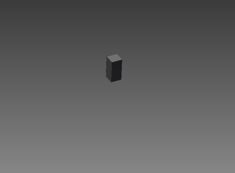

2. Select them both
3. Run macro, interference is left behind
Gavin Bath
MFG / CAM Technical Specialist
Design and Motion Blog
Facebook | Twitter | LinkedIn | YouTube
