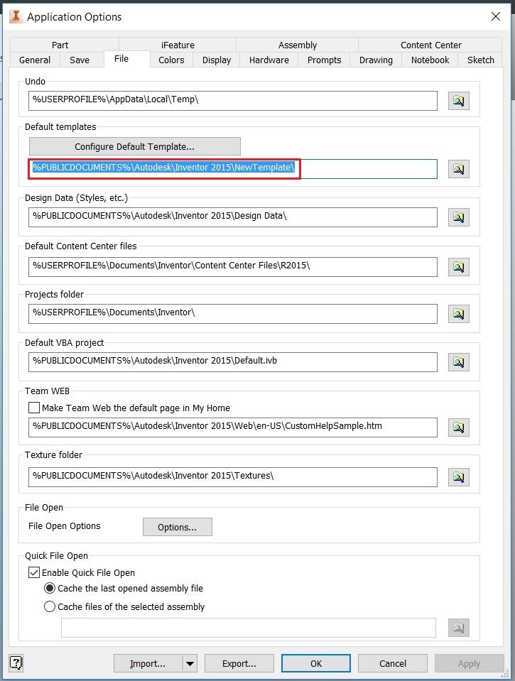

Hi @frederic.vandenplas,
Drawing template path can be changed to desired location.
Go to "Tools" tab -> click on "Application Options" button -> a dialog will appear. In that, click on "File" tab -> under "Default Templates" -> template can be changed to desired location as shown in below image.
After changing template path, click on "General" tab -> under "Startup" -> check "Startup action"-> enable "New from template", new template can be specified from template path.
On running following VBA code
MsgBox (ThisApplication.FileManager.GetTemplateFile(kDrawingDocumentObject))
Following message box will appear with new template path.
Please feel free to contact if there is any doubt.
