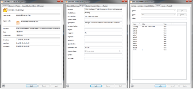

This two columns are mapped to following Inventor properties:
And ART NO is mapped to custom.artno1, but this work not correct. sometimes it is in the properties sometimes not.
And if i insert a Content center part to Inventor then the iProp. will be like this: but custom.artno1 shall be filled with 6 digits.
iProperties CC part.pngS
But in our Vault which is Meridian are this three properties the same:
Part Name=Part number=Custom Drawing no.
For example this part bellow:
The name is GNSS-MIL-I-0005.ipt, partnumber and Drawing number is the same. just the description is different.GNSS I.pngGnss II.pngGNSS III.png
And Meridian is the giver for all this properties.
I have not idea why that is as it is.

My problem is that we have on three properties the same descriptions.
Show on my last messages, the last three pictures.
Also is missing the artno1 in this CC -parts, but i have this column in the familie table.
This is mapped to custom.artno1. but does not work correct. sometimes yes sometimes no.
And so long i work outside of our project file (default) then all Properties works correct.
Then i have only artno1 under Customer Properties.
but if i change the project file to our project (ComrodProject-2018) then i must choose a file type:
because Meridian waiting to this.
After this the iProperties under Custom are completely different, because all this properties comes from Meridian.
I have tried also to tell the Meridian admin, that we don't need this file type but he say yes we need this.
I don't understand why.

Sorry, but no it is not.
All CC-parts has get a new familie description like DIN 7991 A4 etc. and this was not in the Vault before.
Ergo no update will help here.
But if i dont choose a file type also with the right Project file, then all properties are correct.
no Drawing No. etc just artno1 which i need for the part list.
with right prperties without choosing of file type..pngt
this means all customer properties will by over written from Meridian if i choose the file type.
