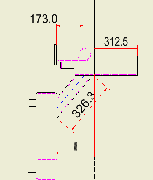

Buenos días.
El otro día acotando una proyección de una vista (que previamente había rotado para alinearla a la vertical dado  que en el conjutno está inclinada, me fue imposible acotar una distancia. La cota me aparecia como en el dibujo
Alguno sabría decirme cómo soluiconar esto, o si tiene solución?

Could you please try to formulate your question in English?
Solution;
  • select the View then Right Mouse Button.
  • Then General Dimension Type set to Projected!!
Regards,
Arthur Knoors

Good Morning
A few days ago I had a problem delimiting a projection view (previously  it was rotated, because the original was in strange position inside of the assembly and for the drawing the normal projections didn't work) Delimiting that dimension was impossible to me, It appeared smudgy and I haven't known why.
If anybody knew a solution or and a viable alternative of that I will be very thankful.
thanks a lot and have a nice day!
bradeneuropeArthur
Do you mean to fix the drawing-dimensions again after the model file has been rotate and repositioned?
