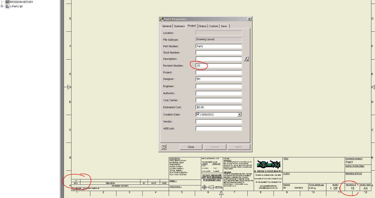

Not entirely sure if this is what you want but it works for me.
Brendan Henderson
