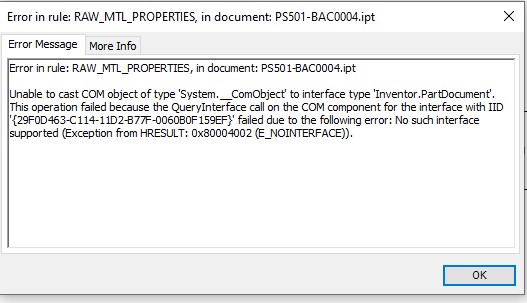

@Andrii_Humeniuk I am running into a snag as I'm updating all of our department's files to use this code. If I open a single drawing (IDW) of one of the parts that use the code, everything works fine. However if I try and open multiple drawing files at once and try to save them all at once, I'm getting this error message for the ipt files and can't bulk save the drawing files. I did some digging on here and don't understand why it's throwing this code when you have the file document specified as a part file. Any ideas?
Error message:
Unable to cast COM object of type 'System.__ComObject' to interface type 'Inventor.PartDocument'. This operation failed because the QueryInterface call on the COM component for the interface with IID '{29F0D463-C114-11D2-B77F-0060B0F159EF}' failed due to the following error: No such interface supported (Exception from HRESULT: 0x80004002 (E_NOINTERFACE)).
More info:
System.InvalidCastException: Unable to cast COM object of type 'System.__ComObject' to interface type 'Inventor.PartDocument'. This operation failed because the QueryInterface call on the COM component for the interface with IID '{29F0D463-C114-11D2-B77F-0060B0F159EF}' failed due to the following error: No such interface supported (Exception from HRESULT: 0x80004002 (E_NOINTERFACE)).
at ThisRule.Main()
at Autodesk.iLogic.Exec.AppDomExec.ExecRuleInAssembly(Assembly assem)
at iLogic.RuleEvalContainer.ExecRuleEval(String execRule)
Regards,
Kenny
If this post solved your issue please mark "Accept as Solution". It helps everyone...really!
Andrii_Humeniuk
Hi @kwilson_design . This is due to the fact that earlier the code received the document from the active file, if you replace the 2nd line with ThisDoc.Document, then the rule will receive the document from the file in which the rule is located.
Sub main
	Dim oDoc As PartDocument = ThisDoc.Document
	Dim oDef As PartComponentDefinition = oDoc.ComponentDefinition
	If oDef.ReferenceComponents.DerivedPartComponents Is Nothing Then Exit Sub
	If oDef.ReferenceComponents.DerivedPartComponents.Count <> 0 Then
		Dim oDrivePart As DerivedPartComponent = oDef.ReferenceComponents.DerivedPartComponents.Item(1)
		Dim oDriveDoc As PartDocument = oDrivePart.ReferencedDocumentDescriptor.ReferencedDocument
		Dim sPartNumb As String = oDriveDoc.PropertySets.Item("Design Tracking Properties").Item("Part Number").Value
		Dim sDescription As String = oDriveDoc.PropertySets.Item("Design Tracking Properties").Item("Description").Value
		oDoc.PropertySets.Item("Design Tracking Properties").Item("Stock Number").Value = sPartNumb
		Try
			oDoc.PropertySets.Item("Inventor User Defined Properties").Item("Raw Material Description").Value = sDescription
		Catch
			oDoc.PropertySets.Item("Inventor User Defined Properties").Add(sDescription, "Raw Material Description")
		End Try
	End If
End Sub
