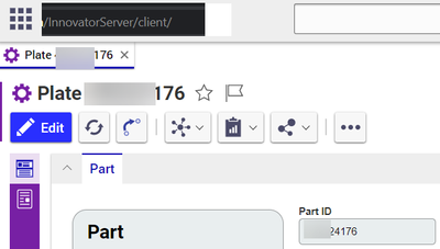

I share a screenshot ot the PLM System (ARAS Innovator) because my explanation might be difficult to follow.

But I did not see a part number in the url. If that is true it means the part number is communicated in a different way and that might be a bigger problem.

Yes, you are totally right, there is no part number in the url. I noticed, too.
I understand that it is the bigger problem to figure out how to communicate the part number to the PLM system.
