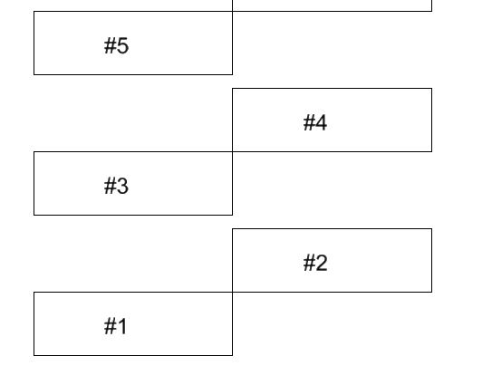

I wish to do numbering on the .idw file which has a base view for zigzag stairs. I want to number the stairs as (#1, #2 , #3.....so on. Is there any way by which we can number the stairs on a click. A message prompt at start for the numbering start from value & later on, on every clicks it shall be incremental text appear on the sheet.

You can add this iLogic rule to the drawing document and run it.
It asks you to give the start number and after that you can just klick anywhere on the drawing to place annotations.
Exit the function with esc-key 🙂

Thanks This worked perfectly, but an we have an option to set the text alignment at the start where we are providing input for the starting number. I mean whether to have text clockwise 90 or ACCW 90 (vertical or horizontal).

Try this to also set the rotation 🙂

Perfect Code as required. Thank You 🙂
