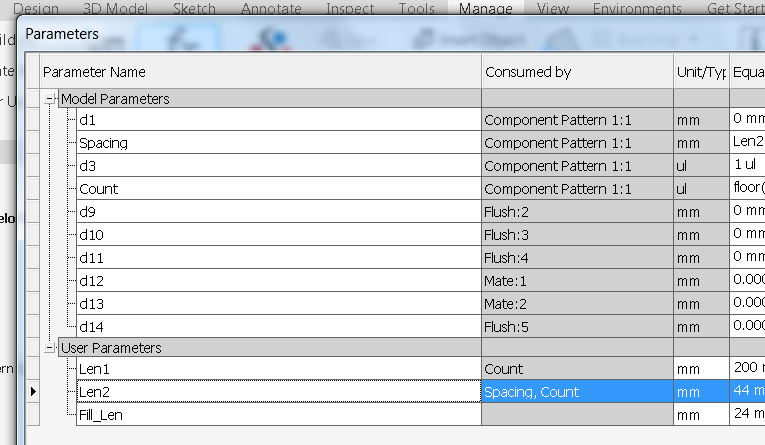

Hello thanks for your help... there is one thing am trying to figure out the coding i just cant find where Len1 and Len2 are coming from
Curtis_Waguespack
Hi @Anonymous ,
Those are user parameters in the Assembly.
I hope this helps.
Curtis
