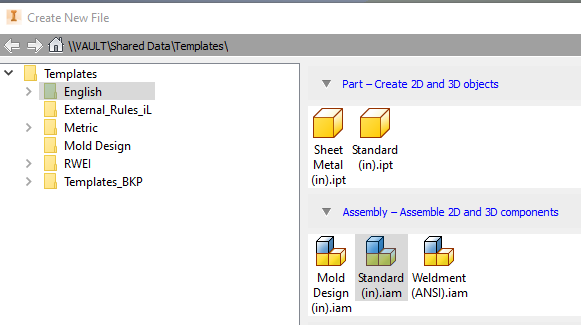

Need to open Create New File dialog box to choose the template
RoyWickrama_RWEI
https://forums.autodesk.com/t5/inventor-customization/ilogic-and-derive/m-p/3563400#M39458
I am using the code in above posting: Thanks to Curtise Weguspack and others.
However, I need to have the "Create New File" dialog box open so that I can choose the template to continue.
Rule is attached here to.
I request help - Thanks.

Thanks. I looked in to the snippets. I found some useful snippet codes.
But, I can't get around with what I need.
Upon creation, I need to have the option to select the template (sheet or part) - Could you fix? Sorry for bothering you. Thanks a lot.

Thanks for the reply.
In case the derived part created going to be a sheet metal part, I need to have the option to select the sheet metal template from the new file create dialog box.  Currently, it is a standard (non sheet-metal).
It may not be necessary to have the new file open dialog box, if if is possible other way around.
Thanks again.
Message 7 of 9
RoyWickrama_RWEI
Thanks. But, I need to have the option to choose the file template from the Create New File dialog box. In case the part is of sheet metal, converting to sheet metal is not the same as the sheet metal created from sheet metal template.
Currently, it goes to a  standard (non sheet metal) where I don't know template came from!
I appreciate if you could shed some light on my request!

You can specify the path of sheet metal template while creating new part document.
Dim oPartDoc As PartDocument
oPartDoc = ThisApplication.Documents.Add(kPartDocumentObject, path of sheet metal template)
Thanks and regards,
CHANDRA SHEKAR G
Developer Advocate
Autodesk Developer Network
Message 9 of 9
RoyWickrama_RWEI
Great. Thanks. It works.
(I still prefer to do with File > New dialog box because the rule is now machine dependent)
