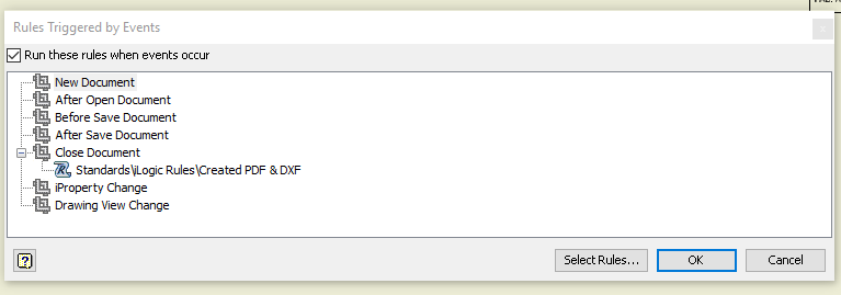

Hi All
I am currently updating a lot of old drawings and updating our standard template.
I have done a ilogic to create a pdf and dxf file on close set as extrernal

Is it possible to get it not to do this?
In the update title block ilogic can I get it to also add the create pdf and dxf to a trigger automatically?
The last thing I would like to do is set the drawing Iproperties to match the model iproperties.
Currently I have to manually go Tools -> Document settings -> Drawings -> Copy Model iProperty settings and tick copy all.
Can this be done automatically?
And update on open of drawing and save eg
I have this code
Dim oControlDef as ControlDefinition  = ThisApplication.CommandManager.ControlDefinitions.​Item("UpdateCopiedModeliPropertiesCmd")
oControlDef.Execute2(True)

Hi @drafting1,
Try the following solution provided in Forum.
https://forums.autodesk.com/t5/inventor-customization/run-ilogic-rule-from-another-rule/td-p/6994012
As Inventor API is not exposed to copy model iProperties from Drawing settings.
Try the following iLogic rule to copy iProperties from referenced document to Drawing document.

drafting1
That helps with some of my question.
In my template I have set Create PDF and DXF on close ilogic.
If I open an old drawing that I want to update the title block and styles I run the Update title block and styles ilogic below. The issue is whilst its doing this it then asks me if I want a PDF and dxf?

Hi @drafting1,
Hoping that following iLogic code helps current situation.
Result = MessageBox.Show("Do you want to export to PDF and Dxf?", "PDF / DXF Export",MessageBoxButtons.YesNo)
If Result = 6 Then
	MessageBox.Show("Run the PDF and Dxf rule")
Else
	MessageBox.Show("Don't run the PDF and Dxf rule")
End If

In the above iLogic rule is for Updating title block and styles, oSourceDoc.Close() is the root cause to trigger "Created PDF & DXF" iLogic rule.
As per the above image, on closing document "Created PDF & DXF" should be triggered.

Thanks, That solved that issue.
So from my understanding I cannot get it auto copy the triggers from the template to old drawings?
