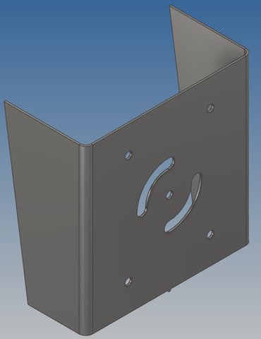

I'm looking for ways to automate the management of flat layouts with iLogic and can't seem to find solutions and hoping perhaps you might have some ideas or experience to share.  Here are my challenges...
I have iLogic creating bent sheet metal parts for a variety of install conditions.  This often creates odd shapes or tapered legs.  In the flat layout, I grab the extents of the flat pattern to determine material requirements.  Inventor appears to be quite random on how it chooses to unfold a part, thus using automation to determine orientation or a specific edge seems impossible.
[Random unfold example 1:]  Part is rotated and aligned with a tapered edge.
[Random unfold example 2:]  Part is not rotated and is aligned with a non-tapered edge
How can I overcome this challenge of figuring out what random position Inventor decided to place my unfolded part in, from an iLogic point of view.  Once I can figure out what the orientation is, I need to set it to an orientation "I" want, which is typically some alignment to the World UCS I had defined in the part model.

That's helpful, but even those rules aren't being followed.  Here's a screenshot of the image I used in that idea link in my OP and it's not following any of those listed rules.

Hi @llorden4,
Please find the below iLogic code for the solution. The basic idea of the solution is to use inventor's Minimum rangebox read only property values (would be same in any orientation) and comparing them with the sheet metal extentents property to identify the problem. if not same then it will create a outside lines on top face of the flat layout and find parallel lines. Depends on parallel lines count condition follows as shown in iLogic.
Please refer to my post here,
Re: Is there a need for optimization in the algorithm used by Inventor for Sheet Metal Flat Pattern ...
Let me know if you have more questions

I believe no one is sure till now about concept used by inventor to make a flat pattern. Please see my post here . Is there a need for optimization in the algorithm used by Inventor for Sheet Metal Flat Pattern view...
@mat_hijs has attached link in answer, which I believe that's what Inventor wanted us to know about it.
To get accurate extent result,
1] we are bound to use ilogic shared by me to make orientation correctly and then extract Extent result
OR
2] we can use iLogic which spits minimum range box values (it would be same in any flat pattern orientation). you can find that iLogic in my post (Link is given in starting).
