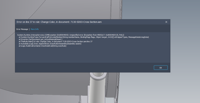

@earl_cody (sorry for the reply), but for some reason I am getting an error on line 37? It was working fine yesterday but it's not working today?

I would think your material asset is not existing locally in the part document.This is why your getting a string error trying to find its name. Use these lines to check the material locally if it exists then move to set it and if it doesnt then the catch comes into play and copies from material library. See sample setting appearance much the same as setting material asset.
'specify material
Dim LibMatAsset As MaterialAsset = libMaterial.MaterialAssets.Item("Glass")
' Copy the asset locally.
Try
   Dim LocalMatAsset As MaterialAsset
LocalMatAsset = partDoc.Assets.Item("Glass")
Catch
LocalMatAsset = LibMatAsset.CopyTo(partDoc)
End Try
if the material isn't already set to the specified material, then change the material
If (partDoc.ActiveMaterial.DisplayName <> LocalMatAsset.DisplayName) Then
'set the material of the part document
partDoc.ActiveMaterial = LocalMatAsset
End If
Regards
Alan

If you have content center parts/parts that are read only then you might get an error like this.
Change this line to ensure document is modifiable.
 If (partDoc.ActiveMaterial.DisplayName <> material.DisplayName) AndAlso partDoc.IsModifiable Then
If that still fails you will need to place in a logger line like so and you can see what document it is stopping on.
Logger.Info("Document DisplayName: " & partDoc.DisplayName)
Regards
