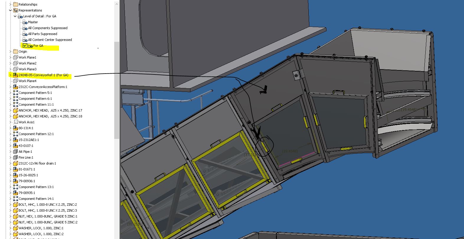

I have been filtering the BOM by view rep for the drawings, which is fine. But the issue I have is that after I put several Ilogic assemblies together to make an arrangement and I create a new level of detail, and set the lod in the illogic assemblies as I go up  to the upper level assemblies the LOD does not display the components that are set in the selected LOD's it's so frustrating> i.e. I have a illogic assembly set to turn off a widget in the assembly. I put it in another assembly (My GA or arrangement), create a LOD there with same name (For GA) but in the upper assembly containing the assemblies set as (For GA) the stupid widget likes to come back, especially if I use paste to put more of the said assembly in the larger (GA) Assembly. WT(ugh). The items poited at with arrow are actually off in the lower level (rolled up ) assembly.
