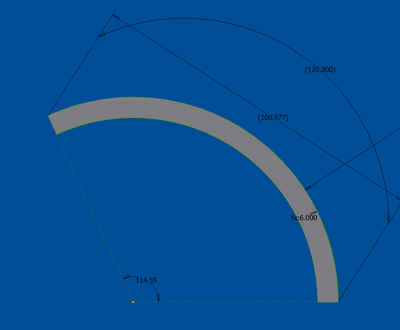

I am attempting to make a part that changes the dimensions it uses to determine its sized based on options in the assembly.  Basically it is a curved part that i want to be able to have its length set by either its Angle, long point to long point dimension, or arc length.
This is currently my Assembly iLogic.
Parameter("BOT_D_PLT", "METHOD") = Wall_Length_Method
If Wall_Length_Method = "ARC LENGTH" Then
	Parameter("BOT_D_PLT", "Wall_Arc_Length") = Wall_Arc_Length
End If
If Wall_Length_Method = "P2P" Then
	Parameter("BOT_D_PLT", "Wall_P2P") = Wall_Length_Point_To_Poiint
End If
If Wall_Length_Method = "ANGLE" Then
	Parameter("BOT_D_PLT", "Wall_Angle") = Wall_Angle
End If
Parameter("BOT_D_PLT", "Radius") = Outside_Radius
Parameter("BOT_D_PLT", "Width") = Wall_Thickness
Parameter("BOT_D_PLT", "Thickness") = 1.0 in

Both of these seem to work.  But when i change the options in the assembly, the dimensions update their DRIVEN status, but do not update to new values.  If i step into the part and run its rule everything updates as it should.
Any advice on how i can make this behave?

TKey_Luttrell
here is a part with the sketch
current assembly parameters
now lets change to the Arc Length method
note the Wall_Arc_Length parameter is 60 in.
but the arc length dimension on the sketch is 62.832 in.
despite the PART parameters
showing 60 as the Wall_Arc_Length
now if i run the rule manually in the part (which we know has already been run because the driven dimensions have changed.)
NOW everything is correct
now lets step back into the assembly and change the arc length, just to see if it updates without a change to the driven dimensions
changed it to 120 in, and it updated immediately.
changed the method to Angle.
As you see the Angle is now the undriven dimension, but it is not 60deg like it should be.
My current theory as to what is happening here.  is that when the rule is called the parameter ANGLE is a Referenced Parameter, and thus cannot be changed, and despite the fact that it IS NOT a referenced parameter when it gets to the point where i tell it to change it still thinks it is, so it doesnt change it.  But when i rerun the rule it is a Model Parameter and can be changed.

TKey_Luttrell
