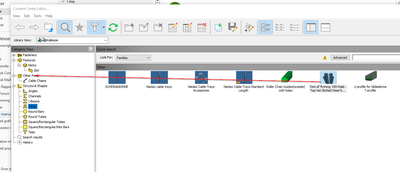

I have create a lot of famille in content center. But I might like to move some of my old familie to new foldes. is that possible ?

As with most things this will entirely depend on if you can do this manually. I am assuming you can't as this is content center and it is rigid. You likely have to republish the parts to the new location. Let us know if you can do it manually and then it can likely be done by code.

I have done that in the past with some freeware to edit the database file. I need to take a look how it was called. Still it is very tricky and hard to understand how to change tables in a database. If things go wrong there it will really go wrong and corrupt the file.
But it worked...

I found the program I used:
https://portableapps.com/apps/development/sqlite_database_browser_portable
be aware that files can be easily corrupted and broken and made useless!!!!
