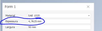

Can anyone help me to solve this link between files problem.
I don't know how to do it.
I want to keep the ipart information: Material, Espessura, and code the same in the part.
Extracted: Publish part.
At the end ipart = publish part = part.

Is the issue that the fraction imperial thickness "3/16" is displayed as decimal mm ? You could change this to a text unit to avoid this conversion. Or alternatively open the content center and change the unit of the column to inch and fraction.
Regards
Alan

I think I understand your issue. You would like several parameters/iproperties to change based on thickness and material change in the form correct? You would like ipart functionality in the custom format. I assume trying to change the material from the content center will erase your custom parameter sizes correct?
This rule will automatically change the CODIGO parameter based on conditions being true. The down side of this method is the code is in each file.
If Espessura = "3/8" AndAlso iProperties.Material = "ASTM A36" Then
	CODIGO = "05.022.01.003.0005"
ElseIf Espessura = "1/2" AndAlso iProperties.Material = "ASTM A36" Then
	CODIGO = "05.022.01.003.0004"
End IF
 This rule here will allow you to change the  CODIGO parameter from external rule. The down side of this method is that it needs to be manually run on the document to update the parameter
If Parameter("Espessura") = "3/8" AndAlso iProperties.Material = "ASTM A36" Then
	Parameter("CODIGO") = "05.022.01.003.0005"
ElseIf Parameter("Espessura") = "1/2" AndAlso iProperties.Material = "ASTM A36" Then
	Parameter("CODIGO") = "05.022.01.003.0004"
End IF
