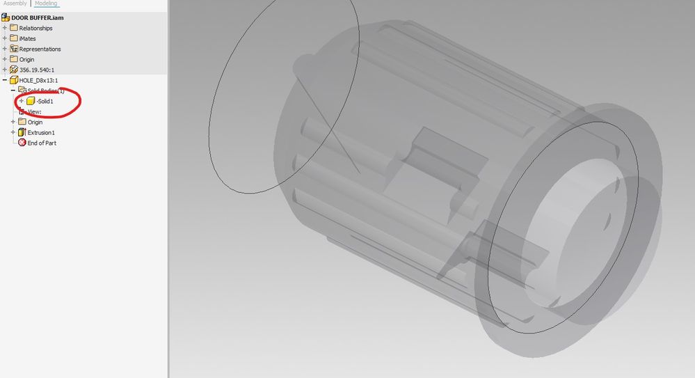

kresh.bell
absolutely fantastic, works great.
Is it possible to edit this iLogic to hide all parts that have the prefix "-" in the solid bodies name? All my hols make parts with the prefix "-"  in the solid bodies name and in drawing are in reality redundant.

kresh.bell
I found one minor problem. Can you fix it?
iLogic works great if solid with the prefix "-" is not part of subassembly.
I'll point to an example of a drawer.
It works for this solid
It doesn't work for this solid
in drawing it looks like this
