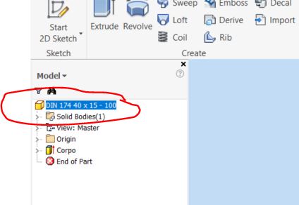

Hi.
I want to change the name to default as in the picture.
How can it be done with ilogic?

Owner2229
Here you go:
Dim oDoc As Document = ThisApplication.ActiveDocument
oDoc.DisplayName = ""

amarcoc
Wow.
That was quick!
Thanks. Worked perfect.
