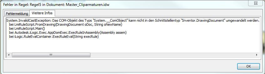

martinhoos
Hi Mike,
i get a message, may be i made a mistake.
I copied your code in a iLogic rule (IDW) and after it runs i get this message:
Thanks for your help!
Regards
Martin
Message 10 of 13
Owner2229
I had to fix a couple of typos, but now it should be working:
