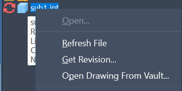

andrew_wade1
That did not work, below is an image of the refresh file function i am looking for. My part file was changed from Released to WIP and will not check out unless i perform this function.
vpeuvion
Hi, ok can you try this :
ThisApplication.CommandManager.ControlDefinitions.Item("RefreshRevisionTop").Execute
 Vincent.
andrew_wade1
still did nothing.
