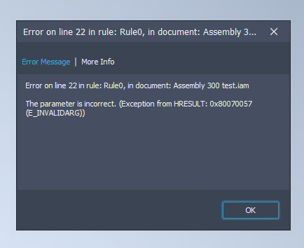

How do i make a drawing temp for this to work?
I have drawing temp but it dosent seen to work. please see attached Error
